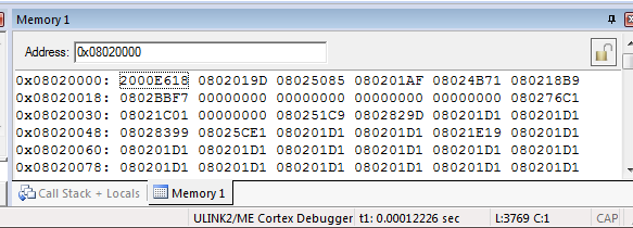

I don't use Atollic, but I'd bet there is a ''Memory View'' in the debugger which you can set to whatever address you want to see the underlying data at.

We are going in circles here, the Vector Table is NOT CODE, you need to dump it as data (32-bit words) not a disassembly.
Please get some Technical Reference Manuals for the Cortex-M3, or books by the likes of Joseph Yiu, and review them. The concept of a Vector Table can be seen in other architectures like the 80x86 and M68K, they are fixed format tables that point at other things.2016-06-24 8:51 AM
Memory View, here in Keil, but most any tool should be able to do this..
