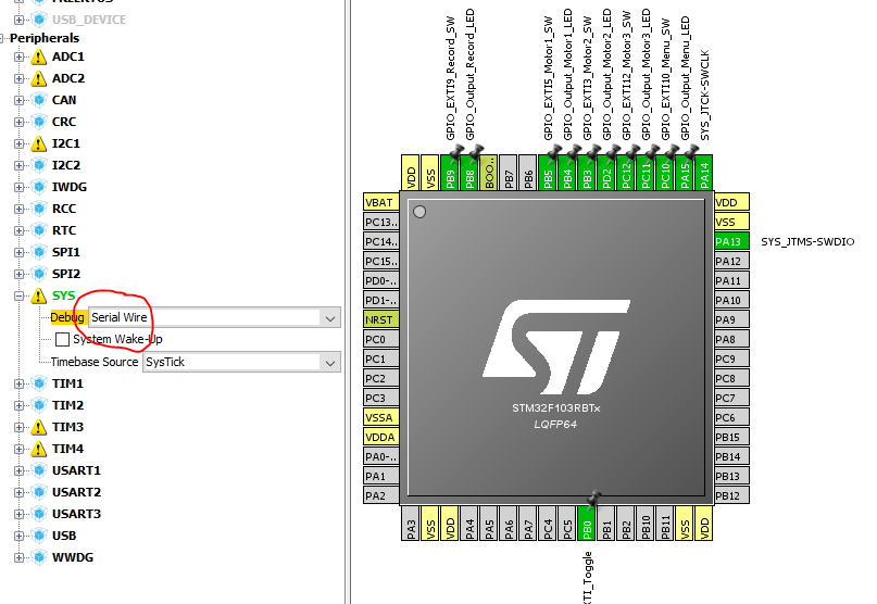

In cubeMx firstly i used 5 pins which are connected to switches and configured them as GPIO_EXTIx also enabled their respective interrupts in NVIC in configuration tab that are External Interrupt 3, External Interrupt 9:5 and External Interrupt 15:10, also for indication i have connected 5 pins to different LEDs and configured them as Pull up and triggered when falling edge

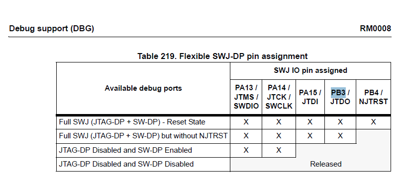

2017-09-22 5:22 AM
Hello!
In Pinout tab->sys select the serial wire mode to release the PB3 PB4 and PA15 pins from TRACESWO NJRST and JTDI functionality(default)
regards
vf
2017-09-22 8:26 AM
I found also that you haven't updated your firmware library(you use 1.4vs 1.9), This problem caused when you selected at Pinout tab->sys '�o Debug'. Normaly the CubMx must have produced __HAL_AFIO_REMAP_SWJ_DISABLE(); at stm32f1xx_hal_msp.c file but didn't produced.
2017-09-22 10:47 PM
Thank You for reply It has helped me a lot and now my issue is also resolved,
