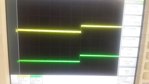

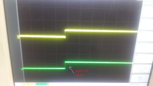

2016-03-28 2:25 PM
I think a permanent pull up will stop watchdog reset execution.
Why would it do that? Actually driving it high, with a push-pull driver can be a problem because you might not be able to supply enough current to get it close enough to ground to be recognized as zero. A 10K pull-up to the supply is not going to break the watch-dog reset. I understand your problem is random, but you are also indicating it is predictable and reproducible on specific boards. Your task will be to instrument the situation sufficiently so you can understand what is actually happening, and to change the situations in ways that might be illustrative of where the problem is. Sharing a common reset allows you to significantly constrain the interaction between the two parts, if that plays a role in the instability. The parts start running from HSI, and even separated, if you plot the NRST signals on a logic analyzer, it might be apparent if the problem relates to one part not resetting properly, or the order in which they reset.2016-03-28 11:27 PM
Dear Clive,
Let me check the NRST waveform of both microcontrollers. Then I will write. What are the chances of ESD distortion.2016-03-29 12:28 AM
