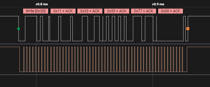

}This piece of code is working somehow strange when i try to send more than 1 byte
I have the following example
uint8_t mm[7]={0x11,0x22,0x33,0x44,0x55,0x66, 0x77 };
I2C_Master_BufferWrite(mm, 5, 0x7A );With a logic analyzer i get the followings.
So i would expect that it sends 5 bytes in order like 0x11 0x22 0x33 0x44 0x55, but it acts like it jumps some certain memory addresses.
What i am doing wrong here?
2023-04-03 11:52 AM
Hmmm,
i later found out that declaring my "mm" array as short mm[7] = { ......} makes the code works as expected.
But i wonder why?
It seems like normal uint8_t is using actually 2 bytes of memory?
This somehow confirms my guessing, that the dma points by 16 bits in the memory counter.
I'm not sure if this is compiler related, and not mcu
2023-04-03 1:46 PM
Maybe not THE answer, but should be changed anyway so the HAL code doesn't use uninitialized structure contents. Change
DMA_InitTypeDef I2CDMA_InitStructure;to
DMA_InitTypeDef I2CDMA_InitStructure = {0};This ensures that ALL of the init structure is set to zeros. Your code leaves some fields set to whatever was in RAM (on the stack).
