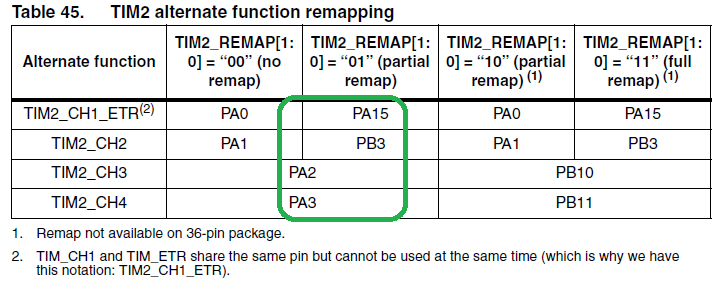

2014-01-25 10:07 AM
GPIO_PinRemapConfig(GPIO_PartialRemap1_TIM2, ENABLE );
From RM00082014-01-25 10:28 PM
