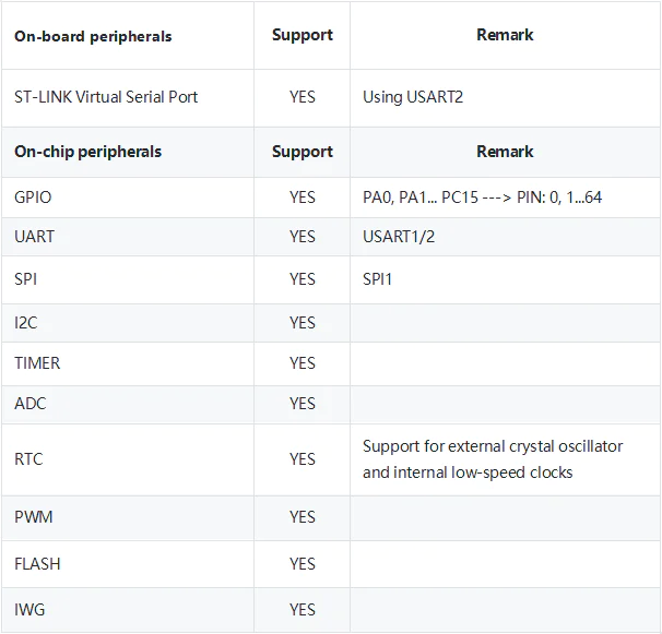

Peripheral Condition
Each peripheral supporting condition for this BSP is as follows:
