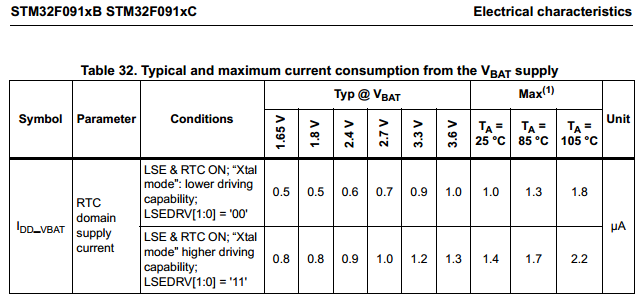

By the way, check the following values from datasheet

VBT draws current only when VCC is not present, and it powers RTC, oscillator and backup register only.

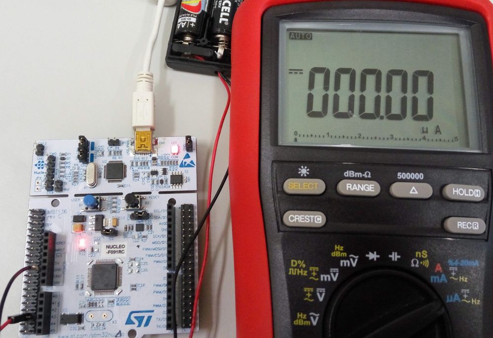

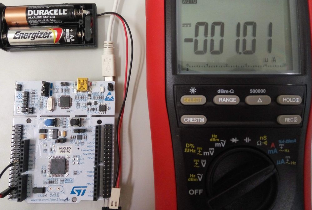

Posted on June 14, 2017 at 04:25
Using two AA batteries Vbat around 2.6V.
with VCC On.
VBat to Gnd impedance, there are few Mega Ohms.
As for your horrible mA current consumption....
Suppose you mcu is healthy and your board is correctly lay out.
Is it possible that your current measuring tool is problematic?
Can you test it with a reference current, like a current source?
