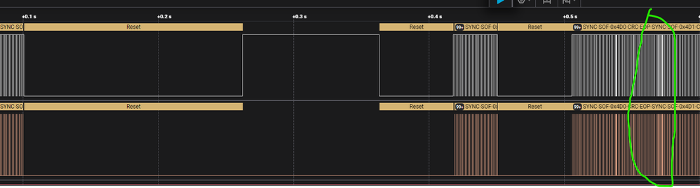

By the way, when I watch the MCU's communication with the Computer with the Logic analyzer, I see that it constantly gives this table Dec:

But if I press the reset button, a different result comes out:
After NRST
I think the MCU is trying a connection in the marked field;
