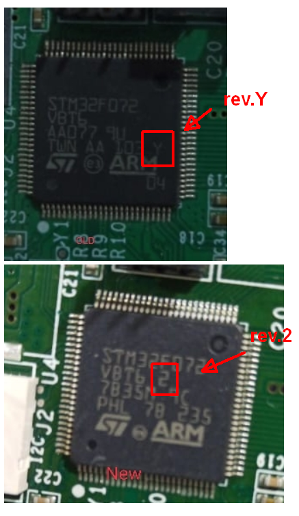

We have facing issue on microntroller we have recieve we have serial product and curretly we are using STM32F072VBT6 controller but we have order new lot and we are recieve STM32F072VBT6 2 and both are behaviour diffrent so what is major diffrence between them ? please suggest me.

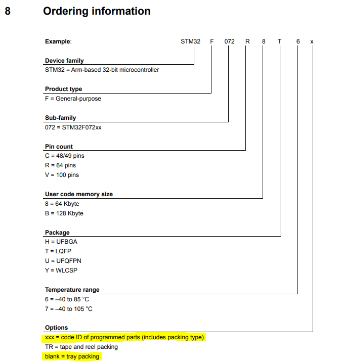

Hello @YShah.1 ,
As already mentioned in the datasheet DS9826 and precisely section 8. ordering information, this marking indicates the options as shown in the below figure.

This is the chip revision
Check errata to find out if there's any relevant difference between the revisions - most likely, there is none.
