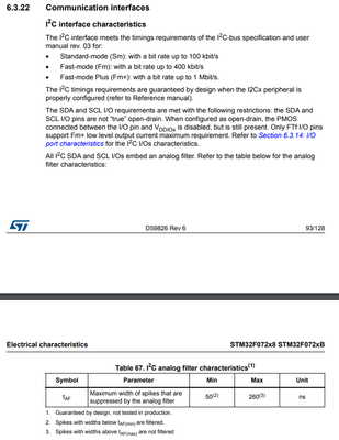

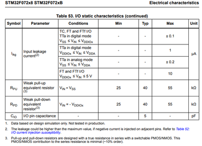

The capacitance of the bus, as the name suggests, is defined by the whole bus - not just the microcontroller!
IO pin capacitance will be in the chip's Datasheet - under electrical characteristics:
The following pages give further AC characteristics
See also:

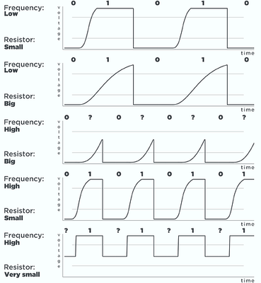

See this post:
It contains this diagram - which shows you the effect of the pullup value:

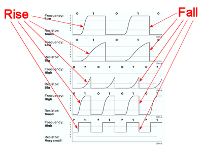

"Rise Time" means specifically the time it takes the bus to rise from the low level to the high level.
This is controlled by the pullups - not the drivers.
"Fall Time", conversely, means the time it takes the bus to fall from the high level to the low level.
This is controlled by the drivers.

Nothing to add: also very clearly to see the effect of a pull-up (raise time) vs. Open Drain sink for fall time.
A very great picture! (explaining the importance to have the right pull-up values).
