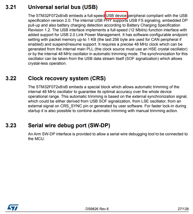

@Batuhanoguz wrote:I want to write data to my usb flash drive !
You wound need a USB Host for that - the stm32f072rbt6 has only a USB Device:
@Batuhanoguz wrote:can I do that with my mcu?
No.
