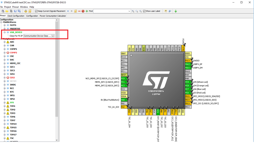

After few hours of debugging I found that there is a problem within the example provided by ST. Instead of using their examples, I tried to generate the code with CubeMX and it worked.
There is a thread that help me in my debug :
https://community.st.com/0D50X00009XkgkoSAB
Here a printscreenof CubeMX Configuration :
So, like ST says on their web site, you no longer need to install the Drivers when your using Windows The Driver USBSER.sys will handle the CDC communication. I also tried with the ST VCP 1.4.0 Driver and it work well too.
