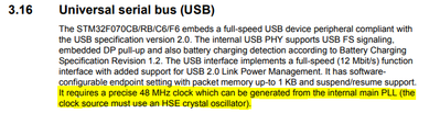

Hello @CWedg.1 ,
Did you activate the USB?
If yes, note that the HSI cannot be used for the USB clock source. This behavior is mentioned in AN4879 and precisely in section 4.FAQs (frequently asked questions) and also in datasheet section 3.16 Universal serial bus (USB).

Hello @CWedg.1 ,
