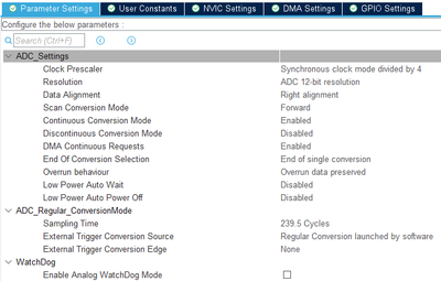

the ADC configuration:

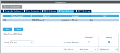

the DMA configuration:

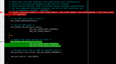

when i run the code, the fail point is:

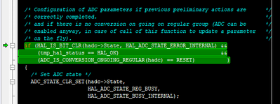

I have investigated the fail handle, the first time that the MX_ADC_Init() fail is after the assertion of the parameters:
at the stm32f0xx_hal_adc.c :
i can only guess that there is an issue implementing the parameters into the ADC
