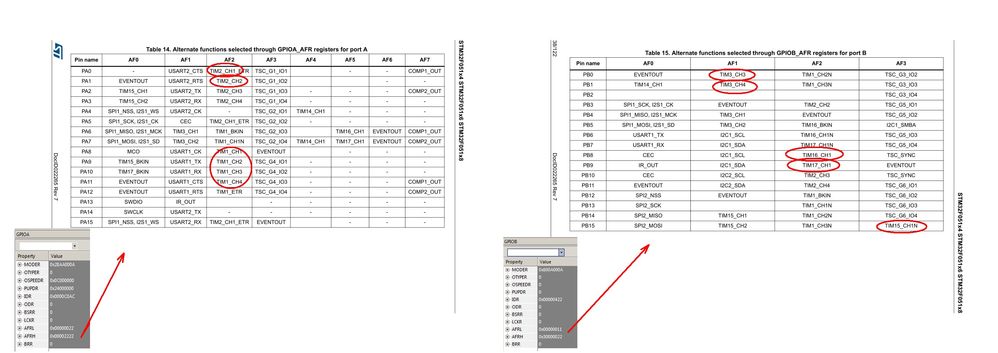

stm32f051 config with stmcubemx
but, timer1 and timer2 and timer3and16and17 not working for pwm generation
only timer15 good work
why????

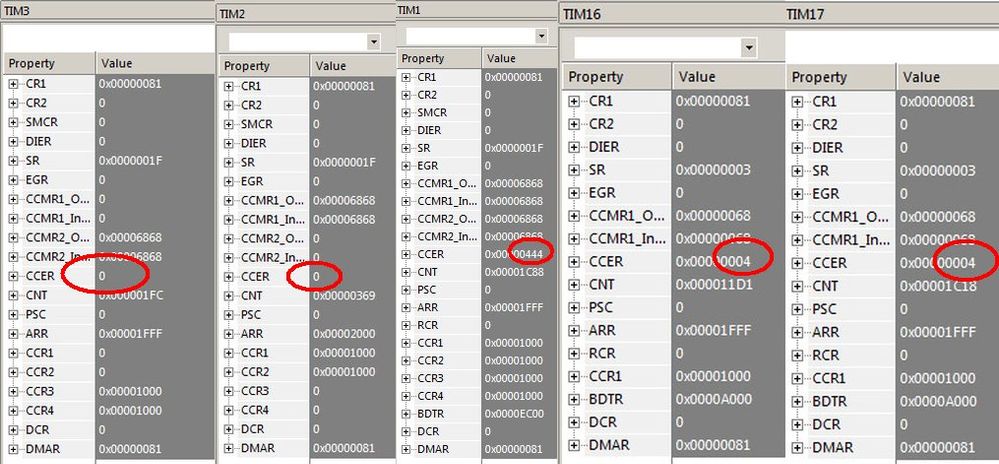

You enable only the "inverted" of the complementary channels (TIMx_CHyN), look up the CCER register's description in RM:
TIM2 and TIM3 don't have complementary channels, that's why CCER there is completely zero.
However, in the GPIO AF, you have chosen the "direct" channels (without N at the end) - in all timers, except TIM15 - which you say does work.
You enable the "inverted" channels probably using HAL_TIMEx_PWMN_Start(); functions. You have to find some Cube/HAL function, probably similarly sounding, which enables the "direct" channel. I don't use Cube/HAL.

Read out and check the content of the timer's registers, also check the content of registers of GPIOs related to the pins you want to use for PWM.

Nobody knows as long as you don't post the contents of the relevant timer and gpio registers.
Nobody is going to build a board just to test your code. Nobody knows the pinout of your system except you.

We told you to:
2020-02-26 2:20 AM
I'd be very glad to help as soon as you've posted the pinout and the GPIO and timer register values.
