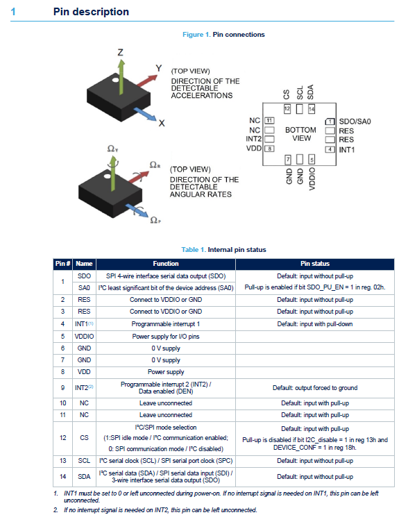

Is there any Schematic of ASM330 connections over SPI to STM micro-controller for our Reference design .
Please share if there is any reference design of ASM330 connections over SPI
