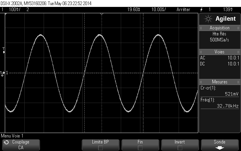

I
check
the integrity
of the signal
source
to the oscilloscope

'' The capacitance of the scope probe may affect the Xtal oscillations. If the device has the functionality - get he device to output the LSE on an IO pin and check that with the scope. ''After

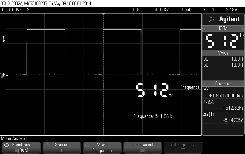

with other peripheral.I activated
the
512
HZ
output
to measure the
signal
:I bought
high-precision
6.2
Pf
capacitors,
the
measured frequency
was 404
Hz:
even worse than before
.Capacitors
with
6.8
pf
I have
a frequency of
520
Hz
In any
case
the
two
signal
asvery
unstable.
I said that
I use
quartz
with
capacity of 6
Pf
as recommended by
ST.
And
I
test
the 12
pf,
and:Very stable and good frequency.

. Sorry for my english.2014-05-26 11:33 PM
finally to close the post,
