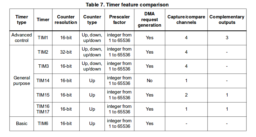

Looking at the DS of 'F051, I couldn't help noticing that there are only 3 timers with 4 channels (TIM1, TIM2, TIM3) which could handle 2 PWM inputs each; and one with 2-channel TIM (TIM15); so that's only 7 PWM channels that could be handled with one 'F051.
You may want to reconsider your choice of mcu.
