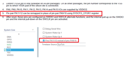

As stated in the datasheet you need to remap the IOs PA11/12 in place of IO pair PA9/10 using SYSCFG_CFGR1 register:
So in CubeMx go to SYS menu and check the checkbox "Pins PA11/12 instead of pins PA9/10". CAN peripheral will be available.
