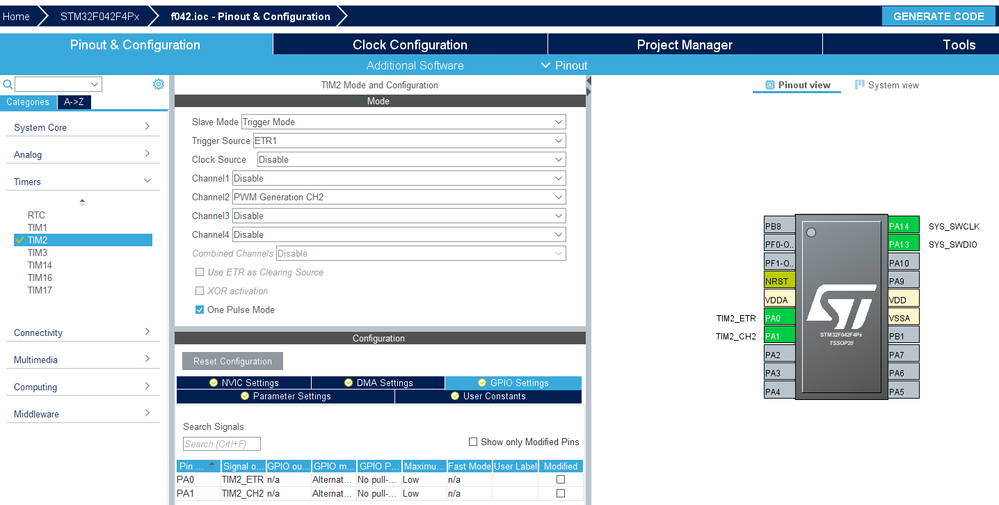

Help find the answer. I want to run TIM2 in trigger mode. If you connect ETR1 to Vdd, then the current at input ETR1 will be 45 mA. If you connect it to Vdd through a resistor, then the timer does not work. Where can I find a diagram of the correct connection of the trigger source? Why is there so much current in this mode?

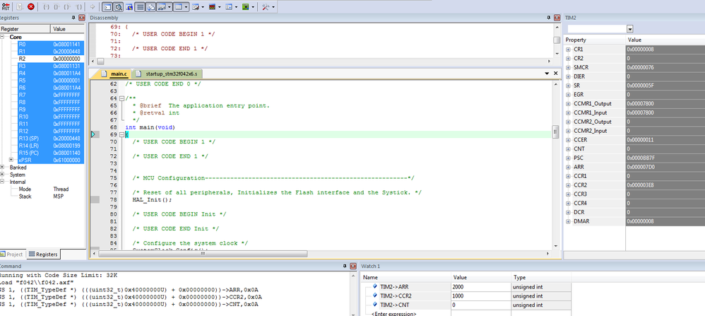

Do you have CH1 set as input (i.e. capture)? Read out and check/post the content of relevant GPIO and TIM registers.
What board is this? Isn't there something external connected to the same pin?
I don't use Cube/CubeMX.

45 mA is way too much for any I/O pin to handle, see absolute maximum ratings in the datasheet. Consider your MCU damaged, and get a replacement. This is most certainly a hardware problem, unless PA0 is somehow set as output. The setup looks right to me, but I don't trust CubeMX anymore even to get the pin setup right, so check the GPIOA registers against the reference manual.
Check the board for defects, bad soldering, etc. Use a genuine debug adatpter instead of cheap aftermarket clones if your Vdd is lower than 3.3V.
2020-01-10 1:01 AM
As I've said above, you have to set CH1 to input - note that PA0 is shared between ETR and CH1.
You have TIMx_CCMR1.CC1S=0b00, i.e. output (compare). Maybe it would be enough not to enable it by setting TIMx_CCER.CC1E.
2020-01-10 2:31 AM
Thanks! Everything worked with this setting.

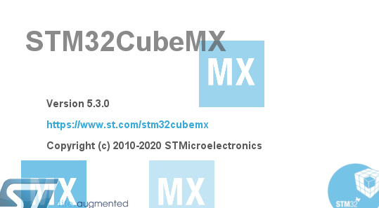

2020-01-10 2:52 AM
Thanks! Version 5.3.0
