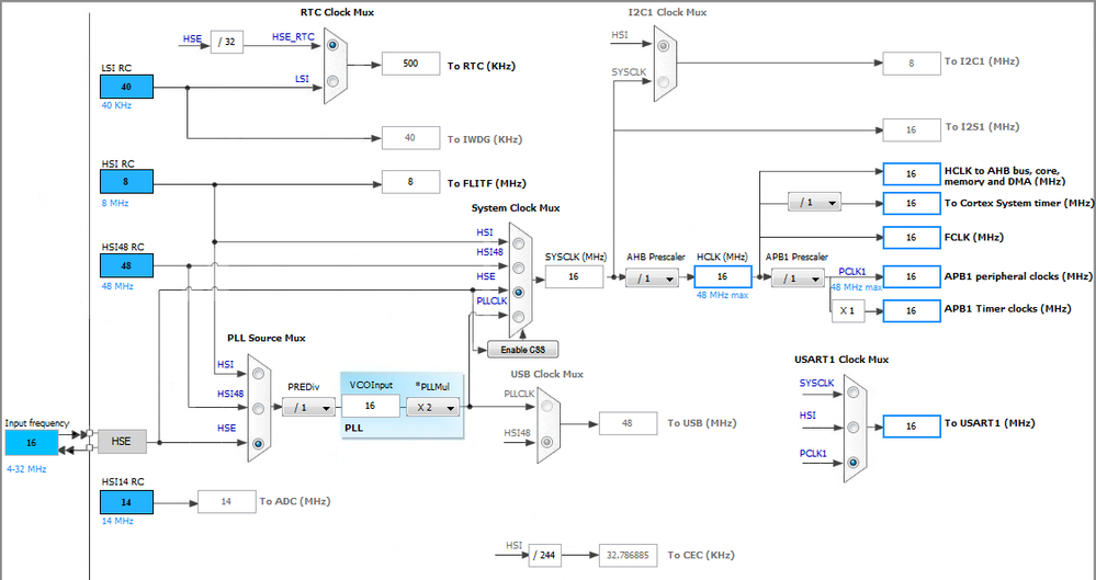

Okay clive1, I use HSE_RTC clock and accuracy improved significantly. But I'll have to use the LSI because I found that the HSE is turned off in STOP_MODE and unfortunately I can not use another package with OSC32 pins. I appreciate if you can give me any tips on how to calibrate/improve LSI clock. Something like check the real clock and reconfigure the pre divider would be valid? Thank you!

Hi, I'm here again! Now I put an external 16MHz oscillator. I measured the frequency of the crystal with the oscilloscope and seems to be all right. But now I have an error of 12 minutes to every 24 hours. My application is totally dependent on the correct RTC and should work for 45 uninterrupted days.So I wonder if this error is normal for an external crystal or there may be something wrong with my settings.

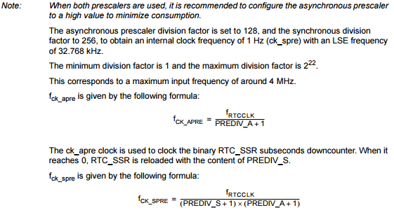

Thank you JW, it's my fault. The dividers starts from 0. Probably this is the problem isn't?Now I will test with this setting: hrtc.Init.AsynchPrediv = 124;
hrtc.Init.SynchPrediv = 3999; Unfortunately I cannot configure the asynchronous prescaler to a high value because it will generate a small error. For reference below the RM0091p573/1008 note:We’re moving the ST Community to a new platform to give you a better and more reliable community experience.
