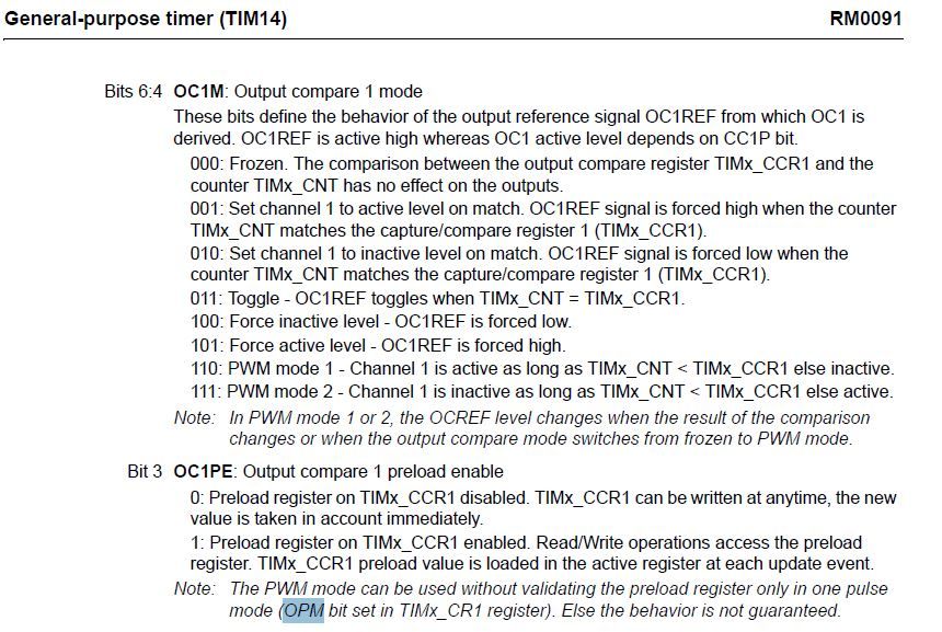

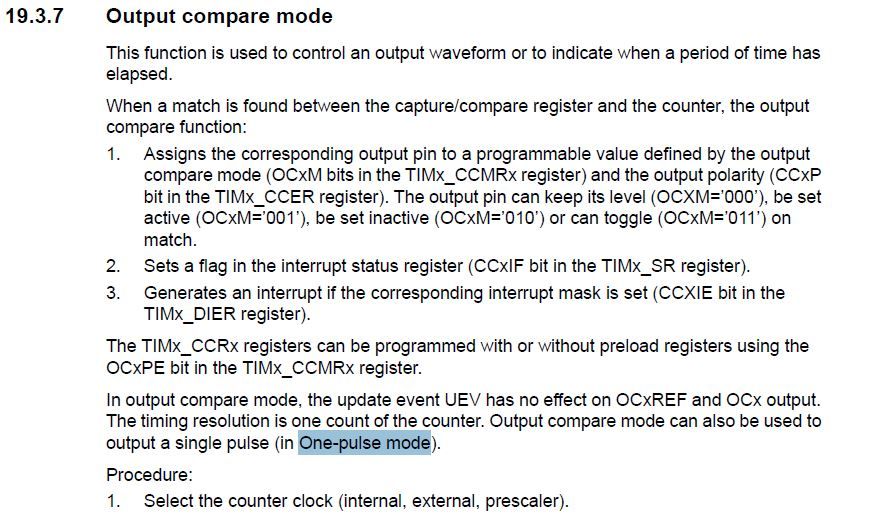

In page 468 OPM is mentionedAlso in page 474

In that case, there must be a mistake in the reference manual, in the TIM14_CR register definition page, that should bit 3 be defined as OPM. I hope someone from STmicro will notice this and report it to the documentation team.
