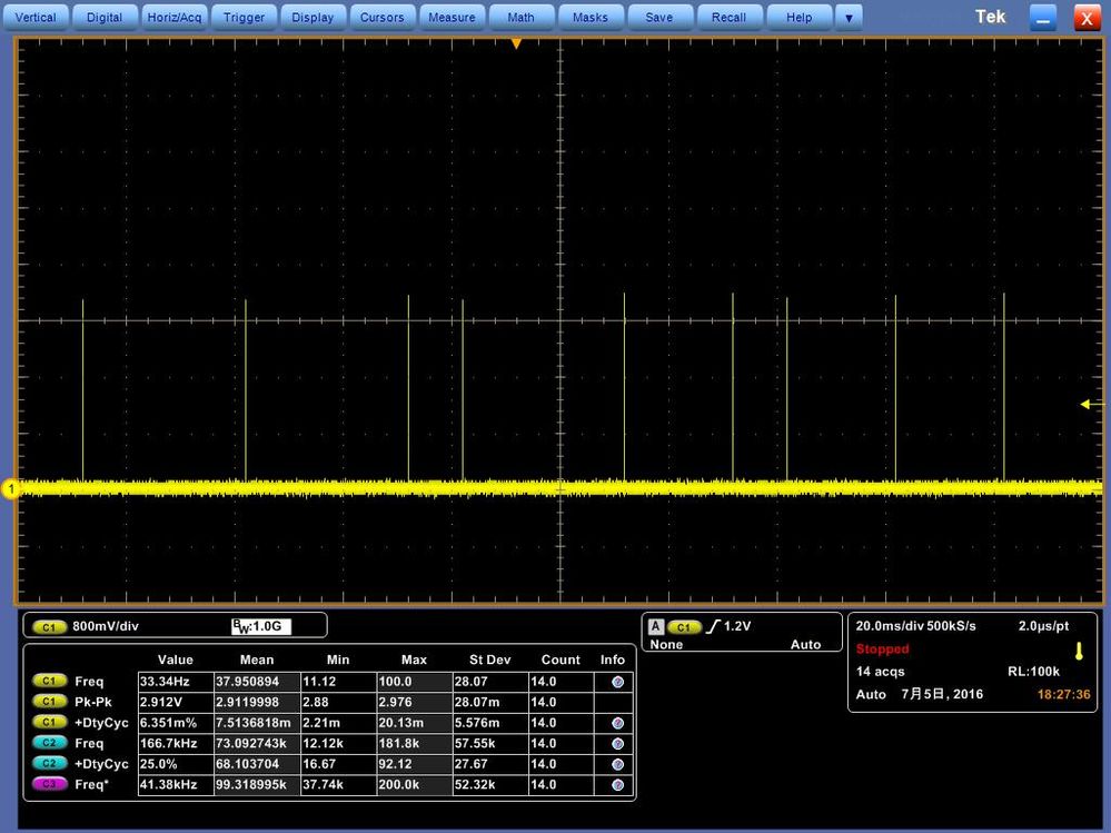

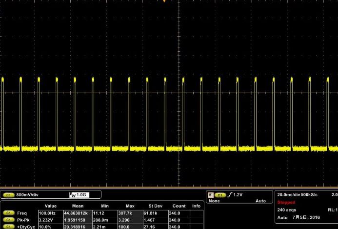

Hi Sir/Madam:
I've encounter a issue about setting Time base on STM32F030R8.I used TIM14 to be time base.When I check the 10ms time base in stm32f0xx_it.c.That was worked normally.2016-07-05 5:29 AM

I'd test this by toggling a GPIO, and not having it running under a debugger. I'm not sure why the trace has missing pulses, but I'm not willing to spend my time diagnosing it.2016-07-06 1:22 AM
Hi clive1, Hannibal and dembek.radoslaw.001
I make a mistake in TIM14_CCR_VAL.It should be set volatile not define in a file. (But, IAR don't show any error or warning before change the variable).After that, it still lose the pulse waveform(I used the example code from en.stsw-stm32140).Thank you for your reply.We’re moving the ST Community to a new platform to give you a better and more reliable community experience.
