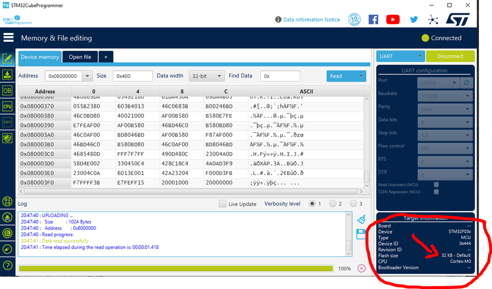

Hello! I am experimenting with a STM32F030F4P6. When I connect it to STM32CubeProgrammer via bootoader (UART), there is an info saying the micro has 32Kb of flash, instead of the expected 16Kb for this part.
Is it possible that this microcontroller really have 32Kb of memory? Anyone had similar experiences?
Thank you.

The same die is used for multiple chips. It is possible, even likely, that the chip contains the full FLASH available on other packages, however only the 16 kB the datasheet specifies is tested and guaranteed to work. You use the rest at your own risk.
Using the same die for multiple chips cuts down on production costs. Only guaranteeing a portion of the FLASH actually on the chip cuts down on testing costs.

The actual meaning of this chip marking is:
STM32F030F4
F - the chip has 20-pin case and 32 KiB of Flash
4 - you paid for 16 KiB
It's similar for STM32F103C8 vs. CB.
The decoding of the 2nd character after the base number is different in different STM32 famlilies. For L4+ series the interpretation extends to: "you paid for one half only so we disabled the second half".

Thank you! Well, if I can really use all 32Kb of memory for the price of 16Kb, then great! I´m using this chip to learn how to program 32 bit micros. Let us see how fast I´m going to reach the 16Kb limit of flash.

Use floating point, and you'll probably get there very quickly
This is the Reference Manual for your part, you can read the tested flash size via a memory location.
