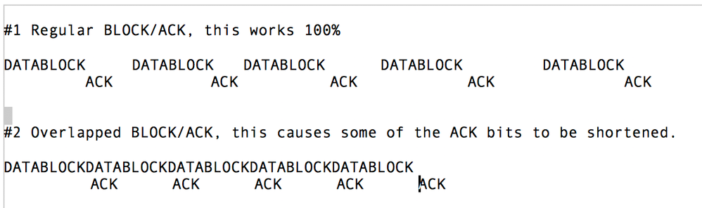

It's a block protocol, with the remote board sending 256 byte blocks and the F030 board sending ACKs (hex 0x06) along the way.
It had worked fine, when the ACK from the F030 was sent after a full block. When sending while there was still incoming data, the start bit of the outgoing data was suddenly shortened a bit, resulting in incorrect data being received in the remote end.

This is a design that has been in production for over a year, but I just recently changed the protocol slightly to speed it up, by sending blocks in burst of 10 and "picking" up 10 ACK's in the other end. That did NOT work, due to the corrupted transmit bytes.
2019-04-20 4:14 AM
Note that is is not all of the ACK's that are corrupted, is roughly 1 in 10 or 20. It depends on the timing or bits coming in on the RX
Here's how it is sent:
