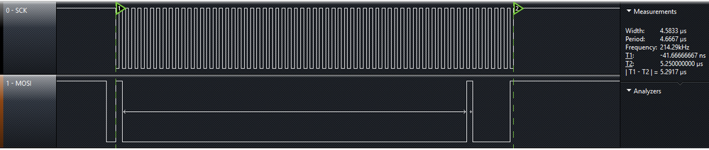

first test without enable any dma interrupts:
you can see result is ok and data correct transfer.

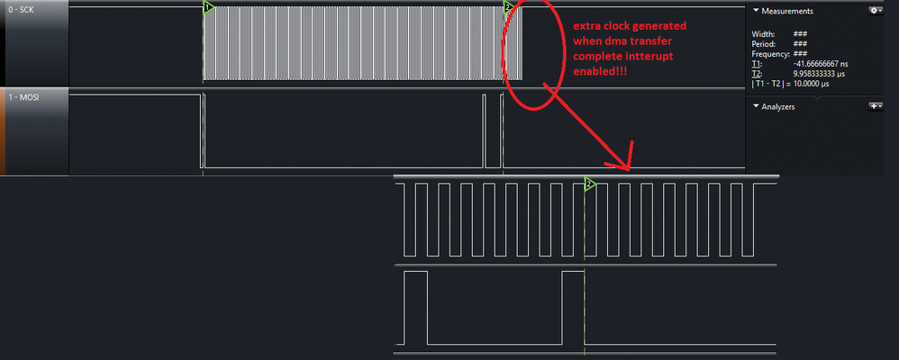

test 2,enable only transfer complete interrupt!:

}and result is:
and you can some extraaaa invalid clock generatee end of data transferedd!!

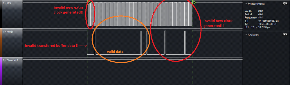

and finaly when half transfer and complete transfer enable i got severaaal extra clock!
following by this code:

}in above code i enable transfer complete interrupt & half transfer data interrupt and i got this result
whats problem????
what's m mistake???
thnx
