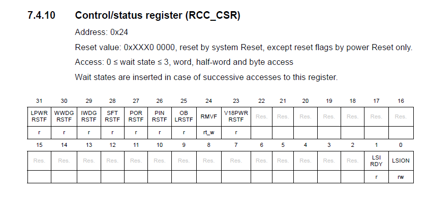

2020-09-11 5:01 PM
After it resets, what does the RCC_CSR register say about the source of the reset?
2020-09-11 9:03 PM
Your code is correct. it doesn't have any error.
Adc is not resetting the microcontroller.
you have to check the source of Reset by reading this register.

2020-09-12 4:15 AM
If I do not clear the the flags after check one by one, PORRST and SFTRSTF are set. If I clear the flags, SFTRSTF flag is set after reset. I'm using stlink to debug.
A question: when I use the "debug" option in cubeIDE, the code is uploaded and the debug "starts", correct? This can set some of these flags and influencing in the result?
2020-09-12 4:50 AM
Just the microprocessor. I made my own board to a specific solution.
But I checked the VDDA, and it was not connected! And as suggested by TDK and sanju, I checked the RCC_CSR register, and PORSTF and SFTRSTF are set. I connect VDDA to 3.3V and it works!!
