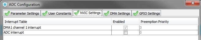

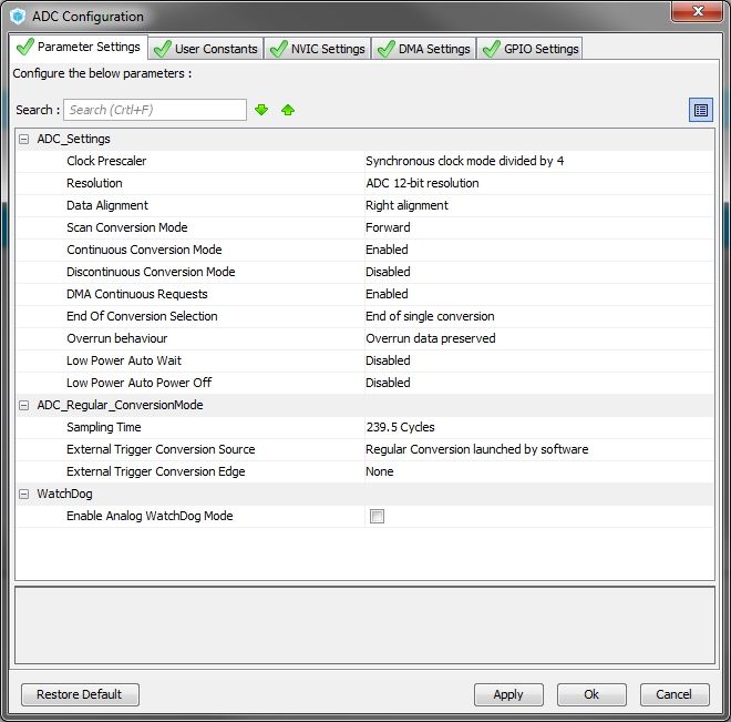

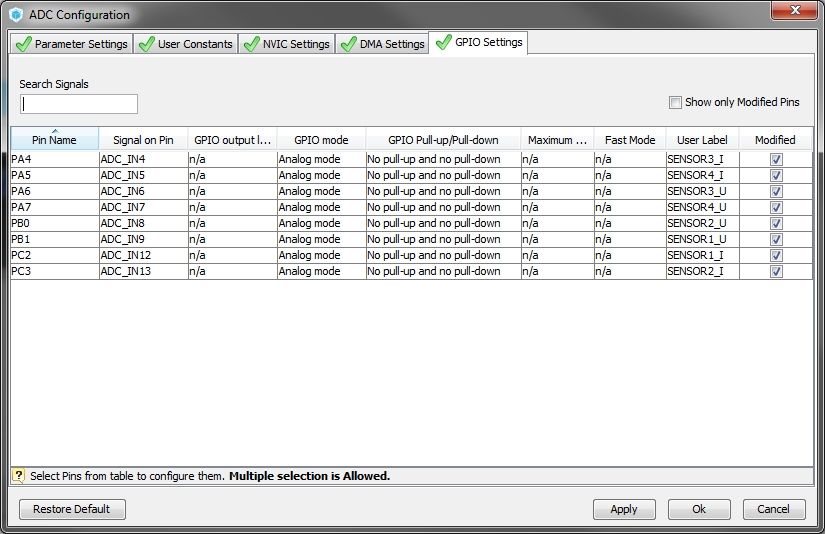

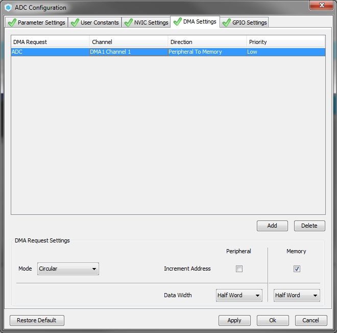

Hi, I have a strange problem with ADC values reading. My MCU and ADC is configured like below:
My main.c is like below:

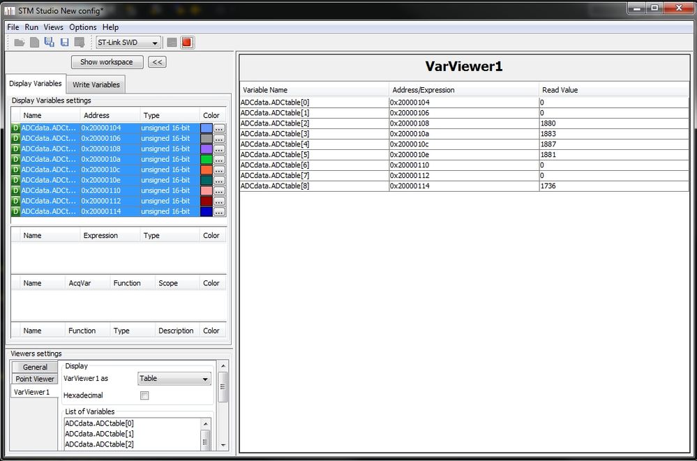

and in the same time (while HAL_Delay(1000); <- from send_my_data) I did printscr from VarViewer1:
And my question is:
What I am doing wrong ? How to read correct this data ?
