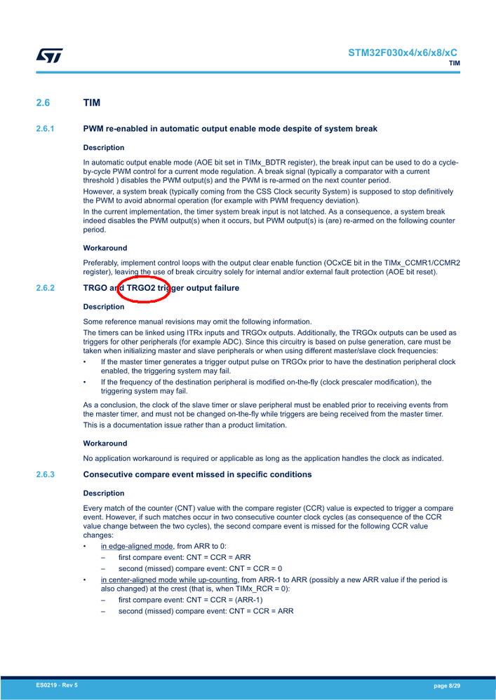

There's no TRGO2 in STM32F030.

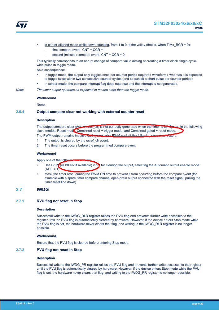

There are no Combined slave modes in STM32F030 timers, nor there is any BKIN2.
