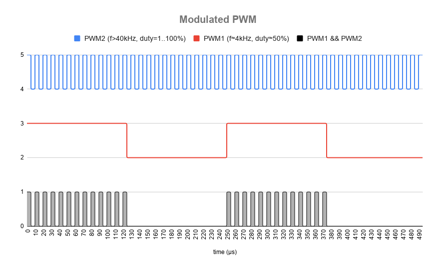

I have a requirement to generate two PWM signals on an STMF030 MCU
  • PWM1: 3-5kHz, 40-60% duty cycle
  • PWM2: >40kHz, 1-100% duty cycle
I need to combine these two PWM signals, using logic AND, into one (modulated) PWM output, like so:
The signals could be combined, by:
  1. Using (external) hardware to combine PWM1 and PWM2, using an AND gate or dual open collector/-drain output.
  2. Configuring PWM1 to generate interrupts on rising and falling edges, and switching PWM2 on and off (x%/0%) in the ISR. PWM2 would generate the desired output.
Is it possible to perform the logic AND of the two PWM signals within the STM32 hardware/timers itself, without wasting cycles and power by having to service up to 10,000 interrupts/second?
