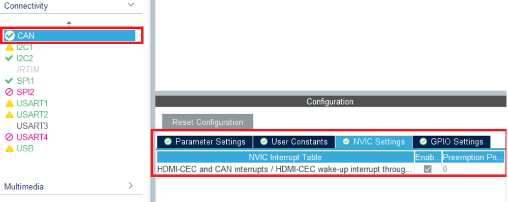

2021-09-21 1:50 AM
This is the option to enable CAN interrupt in CubeMx for F0:
