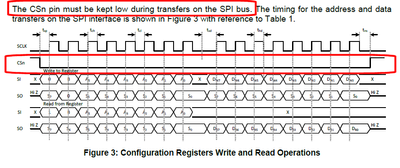

The CC1125 requires that CS remains asserted through the entire communication:

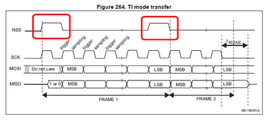

the CC1125 doesn't use the "TI protocol" described in the STM32F0 documentation:
(and that doesn't seem to cover waiting for MISO low anyhow)
