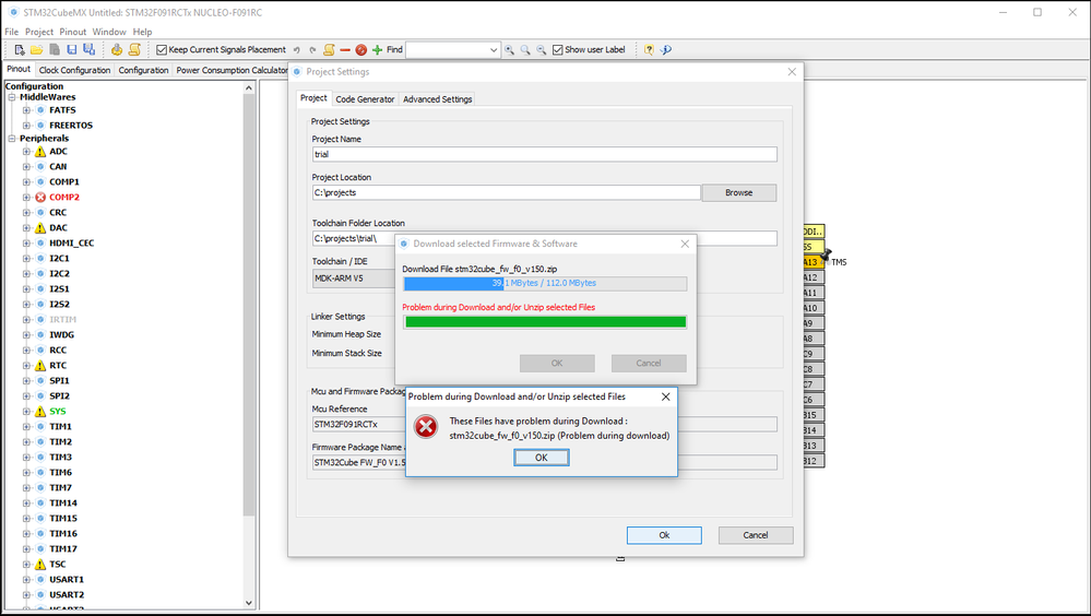

I'm using the STM32CubeMX Version 4.14.0 STM32CubeV1.0
trying to generate a project for the NUCLEO-STM32F091RCT6 board.Please take a look at the attached snapshot: Looks like that when it downloadsthe needed software package something goes wrong. It systematically stopsthe download at 39.1MBytes of 112.0 MBytes.I've tried many times with thesame result. I don't have any firewall activated.my Windows 10 version is the 64bit one, Version 1511.build 10586.164any hint?thanks2016-03-31 8:38 AM

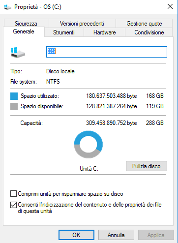

I have successfully downloaded this library without problem.May be your disk has reached saturation and you don't have space enough.-ForumSTM32-2016-03-31 11:19 PM
with 120gb of free space?

Dear user,
We suspect a corrupted download that has been cached at the proxy level. Please try again and let us know and if you're still facing the issue, please send usSTM32CubeMX.log
