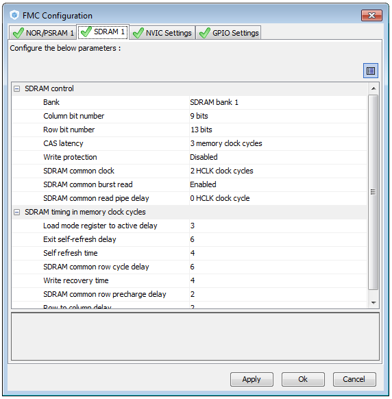

I'm trying to use STM32CubeMX to build a configuration for the EMCraft STM32F4 SOM. In trying to get the SDRAM functional and I believe I have the settings correct; however it looks like the generated code configures the SDRAM but never issues any commands to start it.I was poking around the STM32Cube_FW_F4_V1.1.0 files and found stm32f429i_discovery_sdram.c which contains the BSP_SDRAM_Initialization_sequence function that actually commands the SDRAM to start.I'm curious now what parts of initialization STM32CubeMX does, and what parts it leaves for the developer to implement. Should I need to write a function equivalent to BSP_SDRAM_Initialization_sequence, or should STM32CubeMX emit one and I've just missed a checkbox somewhere.Many thanks,- Malcolm2014-04-24 7:23 PM

I'm familar with the CMSIS startup, but at this time I don't have any data loading into SDRAM so I don't need to migrate the code that far back into the startup process. I'm more interested in finding whether the SDRAM settings I pick in STM32CubeMX are correct. Currently STM32CubeMX produces a main function which does the following:
HAL_Init(); /* Configure the system clock */ SystemClock_Config(); /* Initialize all configured peripherals */ MX_GPIO_Init(); MX_FMC_Init(); MX_RNG_Init();Specifically the MX_FMC_Init() configures the FMC settings I selected in STM32CubeMX with regards to SDRAM configurations - bank, pins, etc. (I also have the NOR-Flash configured in here, and it looks like it's finding the EMCraft boards 16MB NOR chip correctly)I'm just curious if the MX_FMC_Init() function isn't enabling the SDRAM because I forgot to check something off; or if STM32CubeMX doesn't consider enabling the SDRAM as something it's responsible to generate the code for.Many thanks, - Malcolm2014-04-25 8:35 PM

Agreed - and in fact those are the values I'm trying to nail down using STM32CubeMX to build test applications. It seems like all (or most?) of the values have fields in STM32CubeMX, so it seems likely it has all the information to correctly bring up the SDRAM within the MX_FMC_Init() routine.
