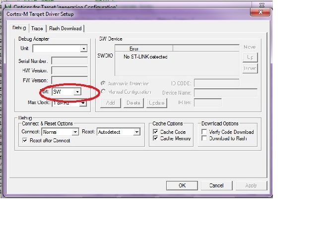

I am trying to generate initialization code for STM32F427ZITx.
Clock and peripherals configuration in a CubeMX is OK.Code generation is OK.All main files (startup, system, HAL drivers, initialization routines) in a generated project seem to be in place,But, when I open a generated project in MDK-ARM, nothing seems to be configured in a Run-Time Environment. And, as far as I understand, the Cube should take care of it.The configuration project builds fine in MDK. But when I am trying to run a debug session, it starts at 0x1FFF5162, and, of coarse, doesn't run.Loading application to the flash doesn't work either.Am I missing something? I tried to research the problem, but the only related document I was able to find is a year old Keil app note on integration of CubeMX into MDK. They recommend to use some very outdated (v.1) family pack.I can write configuration manually in MDK, but don't want to miss the great CubeMX's capability to reconfigure on a fly.Will appreciate any advice on a subject.Thank you,Gennady2015-07-03 6:34 AM
2015-07-04 9:12 AM
My fault.
The BOOT0 pin on a board was hardwired to 1, so controller booted in a system memory.And I didn't pay attention.Thank you,GennadyWe’re moving the ST Community to a new platform to give you a better and more reliable community experience.
