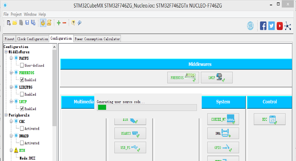

I got same problem with CubeMx 4.21.0.
It can generating code well after I added some codes in USER CODE area and change CubeMX configuration. But after I changed some code in debug.h and cc.h for Lwip, and then I changed some lwip configuration in CubeMX, Finally it will stuck in Generating user source code... as followed pic.
The only method to make it work again is to make a new project with same .ioc file.
I use IAR7.7 in window 8.
May I change Lwip files with cubemx?
