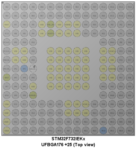

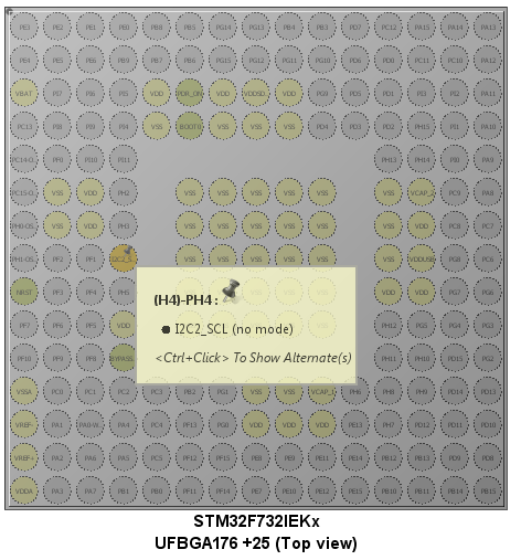

Here is my example :
I2C2_SCL is on H4-PH4 as below :
and if you do a Ctrl Click, you have in blue the alternate functions (H3-PF1 and R12-PB10) :
It is the way we decided to show the alternate functions.

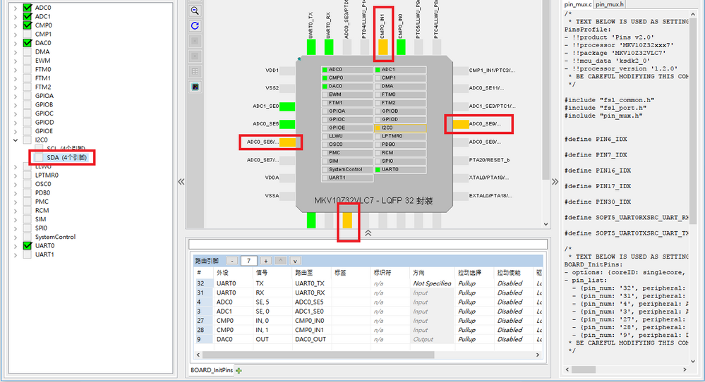

I also need it too!
Let me add a pic for Jone, so that everyone can understand better!
(Following picture is extracted from FSL's(now NXP) KE Pin Tools.)

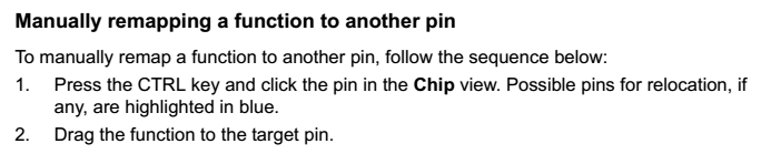

Hi
doe.john.016
,Please refer to the
STM32CubeMX User manual to have more insightaboutManual Remapping
features.Regards
Imen

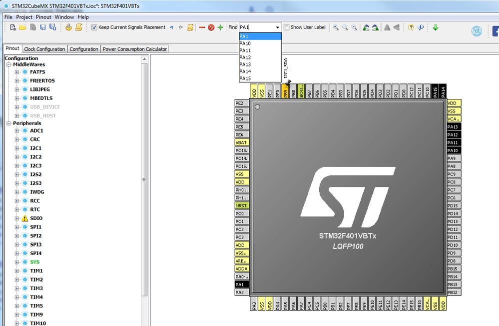

2018-01-29 2:46 AM
Hi
doe.john.016
I was reading this post and I am trying to reproducethe point you highlighted.
From the pin search, I am searching for PA1, I found it immediately in the combo box as below :
Is it what you need?
BR
Jeanne
