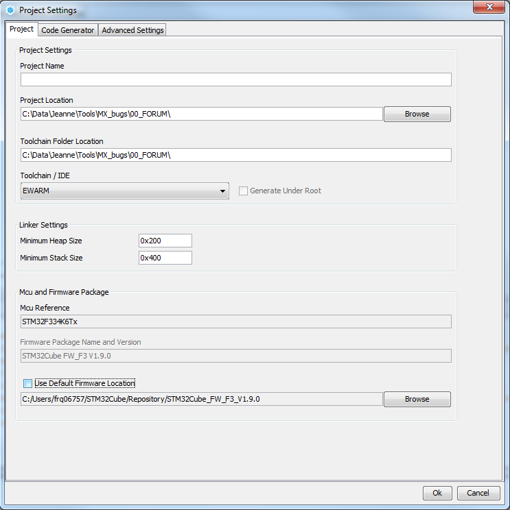

,In the latest CubeMX release (CubeMX4.24), open File/Project Settings, the toolchain folder can be changed and for the Firmware location, you can untick the button ''Use Default Firmware Location'' and set the path you want :

2018-01-30 2:23 AM
The behavior is identical to previous version. I cannot set path relative to the current directory (e.g. '..\..\..\..\3party\STM32Cube_FW_H7'). If I try to set relative path I will get this error:
