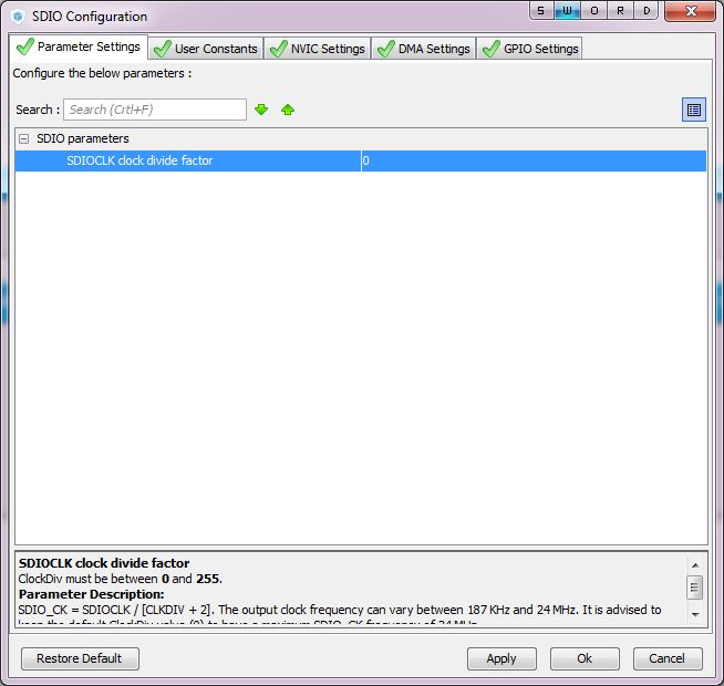

2017-02-28 2:38 PM
Probably I put this clock too fast ? 0 = 24 MHz ??

This is from my Old code :
♯ define SDIO_TRANSFER_CLK_DIV ((uint8_t)0x3)
♯ define SD_DETECT_PIN GPIO_Pin_14 /* PB.14 */
♯ define SD_DETECT_GPIO_PORT GPIOB /* GPIOB */ ♯ define SD_DETECT_GPIO_CLK RCC_APB2Periph_GPIOB/**
* @brief SDIO Intialization Frequency (400KHz max) */ ♯ define SDIO_INIT_CLK_DIV ((uint8_t)0xB2) ♯ define SDIO_FIFO_ADDRESS ((uint32_t)0x40018080)Is there anything different with STM32CubeMX, where can I find this setting on STM32CubeMX generated code ? thanks Clive..
