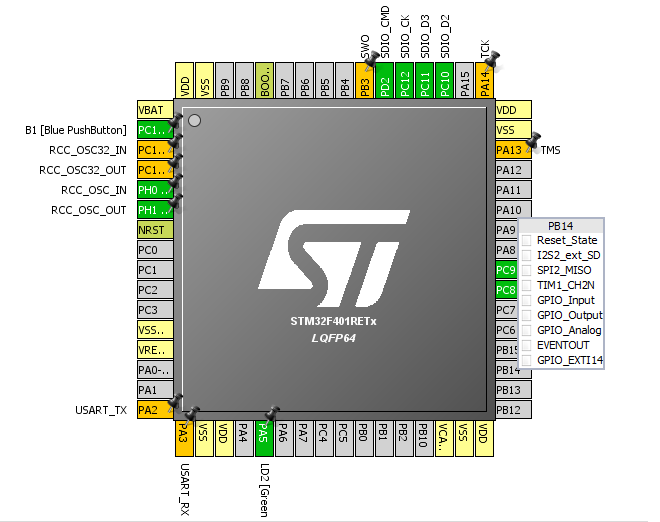

How can I use cubeMX for SDcard ? I have generated for MDK but :
this function doesn't work , from UM1721
User manualDeveloping Applications on STM32Cube with FatFs page 21.:
uint32_t wbytes; /* File write counts */
uint8_t wtext[] = 'text to write logical disk'; /* File write buffer */if(FATFS_LinkDriver(&mynewdisk_Driver, mynewdiskPath) == 0){if(f_mount(&mynewdiskFatFs, (TCHAR const*)mynewdiskPath, 0) == FR_OK){if(f_open(&MyFile, 'STM32.TXT', FA_CREATE_ALWAYS | FA_WRITE) == FR_OK){if(f_write(&MyFile, wtext, sizeof(wtext), (void *)&wbytes) == FR_OK);{f_close(&MyFile);}}}}FATFS_UnLinkDriver(mynewdiskPath);This variable :
&mynewdisk_Driver doesn't exist, which file is related ?
Thank you
