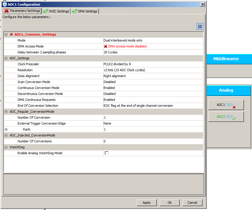

STM32F4 v1.4.0 1. After close and open CubeMx project (create for STM32F4DISCOVERY), i see ADC1 config error (in the previous version of the same here):2015-02-04 10:31 AM

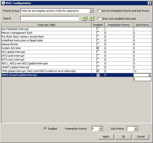

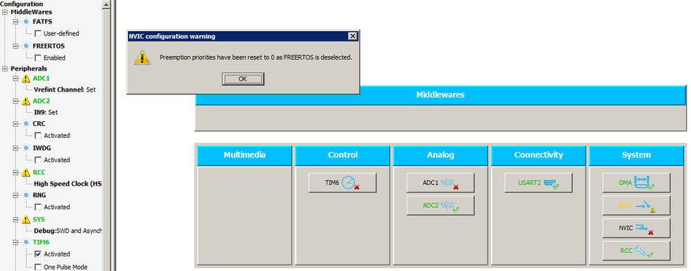

When freeRTOS is disabled, you need to change the priority group to be able to choose sub priority > 0.
