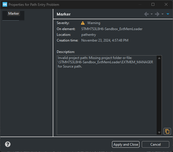

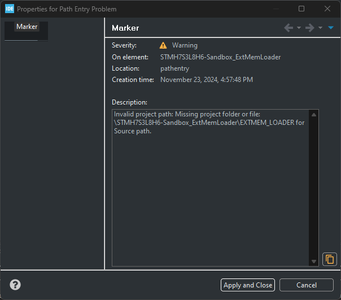

1. Generating Code from STM32CubeMX gives me this warning:
2. The ExtMemLoader has two warnings:

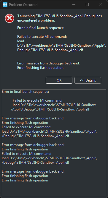

3. It's not possible to start the application:
After that message, I used the STM32CubeProgrammer and erased the flash on the STM32H7S3L8, programmed the "STMH7S3L8H6-Sandbox_Boot" to address 0x08000000, and the "STMH7S3L8H6-Sandbox_Appli" to address 0x70000000. That worked without any issues, but the LEDs stayed dark after I pressed the black reset button. Even a power cycle didn't light up the LEDs.
