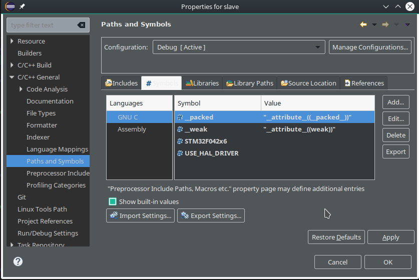

If people don't want to edit the .cproject file and track it down in the code, you can do it in eclipse:
Project/properties/C/C++ General/Paths and Symbols
Select Symbols tab:
Add the '' '' around the Values for __packed and __weak
2016-12-06 4:18 AM
Yes, I also did it like that.
2016-12-06 4:23 AM
Ah, well you're smarter than I. I manually edited all my .cproject files first.
