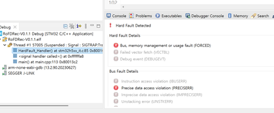

If I run debug, I always got hardfault.
Here is source codes that cause hardfault.

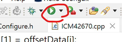

But when I press "Run" button on the top panel, no hardfault.
What's the problem?

Need also to provide the MCU part number and debug yourself the behavior. This article may help you: https://community.st.com/t5/stm32-mcus/how-to-debug-a-hardfault-on-an-arm-cortex-m-stm32/ta-p/672235

As I said, need to debug it:
As we don't have your environment, it's impossible to debug it.. So need to do it yourself and follow what was described in the article.

The weirdest thing is that it works fine when I execute it in running mode.
The problem is only occured in dubgging mode.
