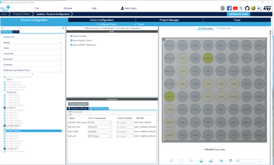

I have configured for STM32L071xx xx controller bare metal. I was not able to find X-Cube-Mems1 for the controller.
Please me know if LIS2MDL (or Mems package) is not supported on STM32L0 series?
PFA screen shot of the STM32Cube Ide

I suggest you to update to the CubeIDE 1.14.0 and use CubeMX 6.10.0. The X-Cube-MEMS1 is available.
