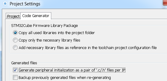

STM32CubeMX does not support this configuration. However, you can follow the following procedure to obtain the code you want: [Note: your application will need to manage the offset introduced by using FSMC_A19 instead of FSMC_A0: when using 8 bit data, this means for example considering 0x7FFFF as the base adress and 0x8000 as the second adress.] Use STM32CubeMX and configure the FSMC for 20 bit address (pinout tab) in order to reserve the PE3 pin:Configure the Project options from the Project menu to generate peripheral initialization code as peripheral dedicated .c/.h files :

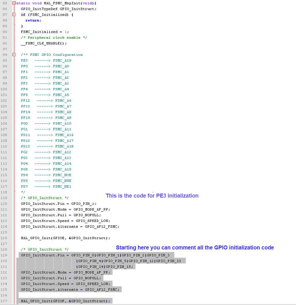

Modify the function HAL_FSMC_MspInit in the fsmc.c file to configure only the GPIO PE3 (i.e. comment all other GPIO initialization code) as shown in example below [Warning: this modification will be overwritten if regenerating the code with STM32CubeMX. So you should copy the code to a dedicated project folder]:
