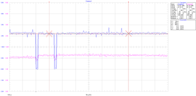

This is the case serial download is working: blue is the character from Computer. Red is the answer from built in bootloader.

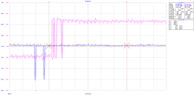

This is the case with a download fail. TX Pin (red) is always low, even with Character on RX Pin. So I think internal bootloader is not running or it is running on a wrong interface.
