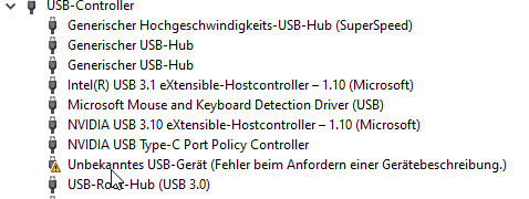

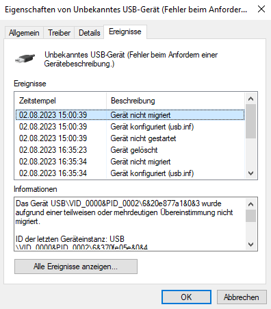

I am trying to establish a USB CDC connection with a Windows 10 computer using the STM3210E-EVAL. I can't get it to work. After starting, I connect the board to the PC via USB and the following message appears in the device manager:

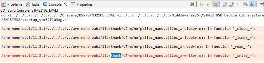

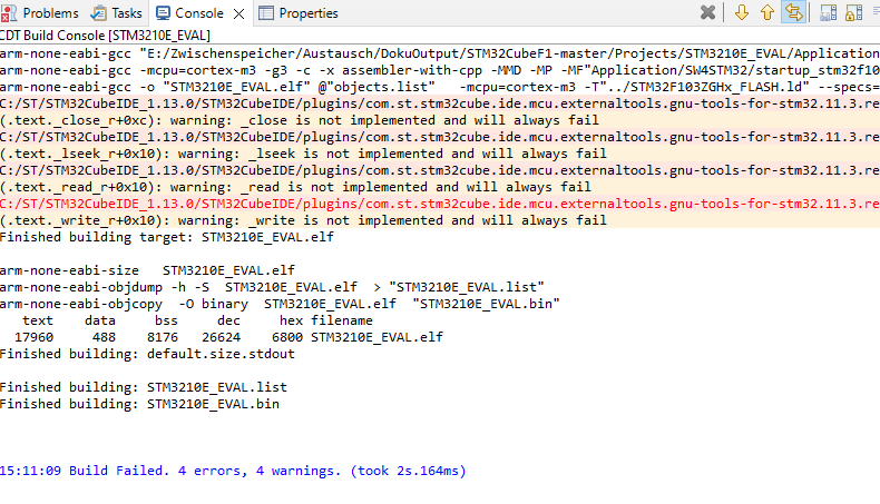

I found something on GITHUB. Unfortunately, this project cannot be compiled without errors.
