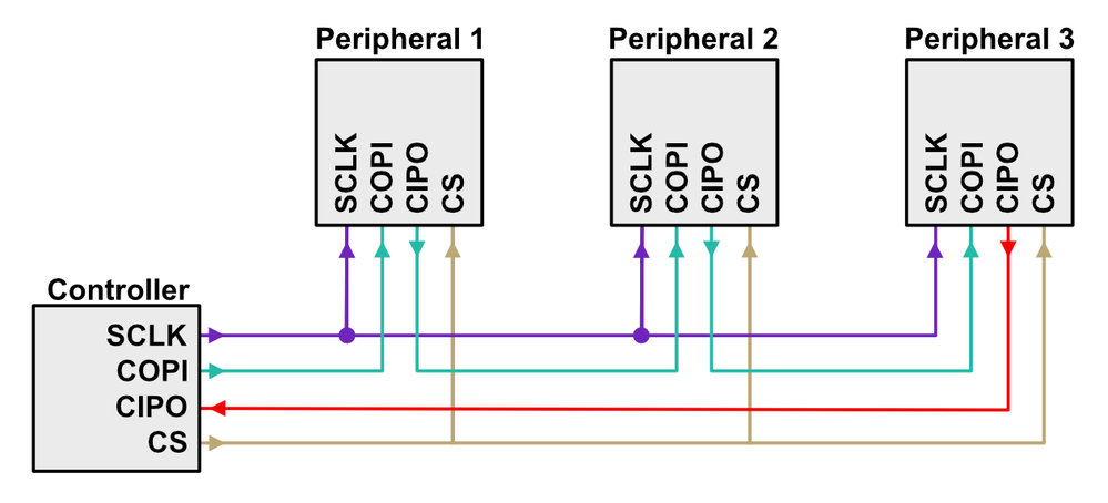

- Remembering that for commercial purposes it is necessary to register a license for the MCU operating in USB Device mode (perhaps that is why many people prefer to use dedicated chips such as FTDI).
If all slave devices are going to be present it could use Daisy-chain mode (it might be more work to do the communication, but it still should be less work than implementing USB HUB in STM32). If one of the slave devices is not present, a jumper on the data line (COPI-CIOP) would be necessary.

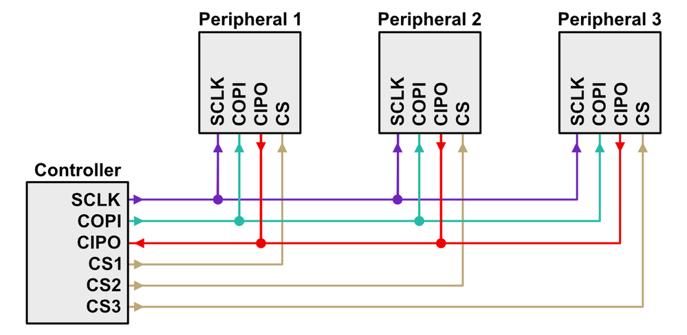

The other way of using SPI would be simpler to implement, but uses more pins, to activate each slave device.
Image source: https://soldered.com/learn/what-is-the-spi-communication-protocol/
If slave devices need to be removable, maybe USB connectors can be used, but using SPI port, USB 3.0 connector line has more data paths as well.
