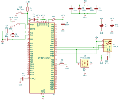

EDIT 1: This is a circuit that is very close to the one I used

Is this a custom board? If so, is a schematic available?
Can you program it using the SWD connections?
> board VCC to USB cable and VBUS_FS
I'm hoping you're converting the 5V to 3.3V with an LDO before connecting it to board VCC, right?

Yes, this is a custom board. And I am able to program it with SWD.
I edited the question to add a simplified schematic of the whole circuit.
The board is not powered through USB but has another power source which provide both 5V (which is connected to USB and VBUS_FS) and 3.3 V (to power the MCU).
